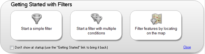

If the Getting Started With Filters page is turned on, buttons representing different expression types are displayed. You can click one of these buttons to insert an expression template.
Click one of these buttons to start with a sample expression.
To prevent these startup buttons from displaying each time you create an expression, select Don’t Show At Startup. You can redisplay them later by clicking Getting Started.
To close the startup page, click Close.
