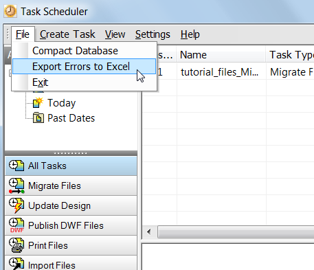

Export errors from Task Scheduler log file to Excel
Task Scheduler generates log files in .mdb format to report task errors. You can export the log file entries of one or more tasks from the Task Scheduler .mdb file format to an Excel spreadsheet.
The Excel file generates a separate sheet for each error type. The first column of each sheet lists the error files. The second column lists the corresponding task names.
Export Errors to Excel is available on the Task Scheduler File menu, and on the context menu for a selected task.
