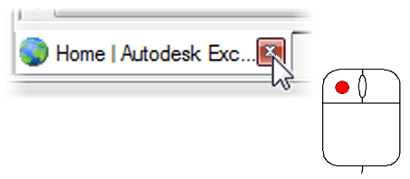

  1. Review the embedded Web page then close it. Click the X on the document tab at the bottom of the screen.

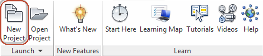

  2. To create the project, click Start and Learn > Launch > New Project
  3. On the new project dialog box, Enter the project name Quick Start Filling Analysis then click OK.
