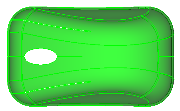

In this task, you import an existing CAD model.

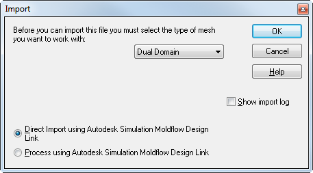

  1. Click, Home > Import > Import
  2. Navigate to the location of the Autodesk Inventor file you downloaded.
  3. Select the file MouseCover.ipt and click Open.
  4. Ensure that the mesh type is Dual Domain then click OK

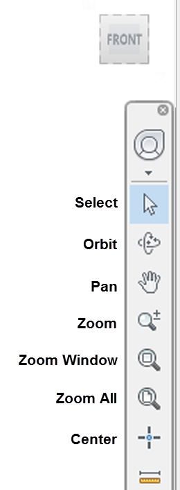

  5. Use the View Cube and Navigation bar on the right to move the model around the screen.
  6. To program mouse buttons, click
    Applications menu > Options > Mouse tab. Set the mouse buttons to your liking.
