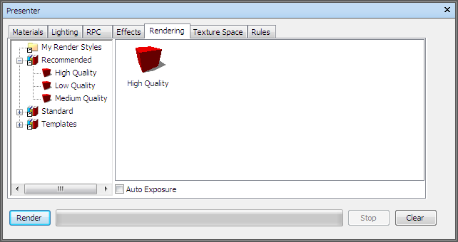

Rendering Tab
Like the Materials, Lighting, and Effects tabs, the Rendering tab is divided into two panes, with the archives on the left and the palette on the right. This tab is where you select in which style and how you want the scene to be rendered. Each archive has a number of different render styles to choose from.
Note: A complete reference manual for all types of rendering styles is included with the Autodesk Navisworks API, (see \API\COM\documentation\shaders.chm). The Autodesk Navisworks API is included with Autodesk Navisworks 2014; it’s an optional feature in the installer, and is installed by default into the API subfolder in the Autodesk Navisworks installation folder.
