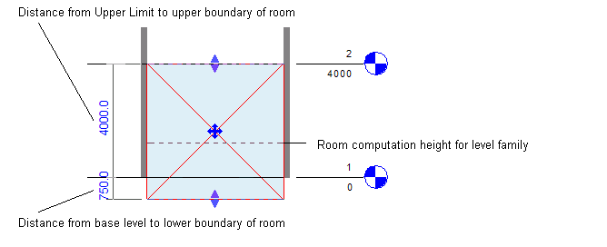

    Revit LT displays upper and lower arrow controls.
  3. To change the upper or lower boundary of the room, pull the corresponding control up or down.
    Revit LT displays listening dimensions to indicate the distance of the upper and lower boundaries from the upper limit and base level of the room. You can enter a value directly, if desired. See Listening Dimensions.
    The dashed line across the room indicates the computation height, that is, the height at which Revit LT computes the area and perimeter of the room. Computation Height is a type parameter for levels. See Computation Height. The dashed line for the computation height displays only when you select the room in a section view.
