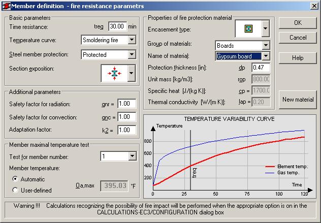

The dialog for the definition of fire parameters includes options to enable the simulation of the temperature of any steel member defined in an analyzed model. The diagram in the lower part of the dialog illustrates variability of the temperature of a selected element in time (in the interval of 0-120 minutes). The temperature of a chosen member for the currently-defined time resistance is also displayed. The diagram is automatically updated after changing any parameters.

The following parameters are defined :
Basic parameters
Time resistance - a required time of fire resistance in minutes (the maximum fire resistance time is 120 min.)
Temperature curve - select a curve for evaluating the temperature of gases resulting from the fire: available curves:
- Standard ISO 834
- external fire
- hydrocarbon fire
- smoldering fire
Steel member protection - select if the member will be Protected or Unprotected
Section exposition - choose from the selection list an icon for an element exposed on 3 sides, on all sides or only with the lower flange exposed
Note: The part of the dialog directly above the diagram varies depending on the selected steel member protection (protected or unprotected element).
Protected element
Encasement type - selection of encasement types; 2 basic types are available: Hollow and Contour
Group of materials - definition of a group of base materials, e.g. boards, plasters, paints
Name of material - definition of one of the materials belonging to a selected material group, e.g. acrylic paint
Protection thickness - definition of a thickness of an insulating layer protecting a column; default values depend on a material chosen from the database
The parameters Unit mass, Specific heat, Thermal conductivity are given as additional information for an insulating material type chosen from the database
In the case of a protected element, it is possible to define a new type of the insulating material and to add it to the database of insulating materials; it can be done in the Member definition - new insulating materials dialog opened by clicking the New material button
