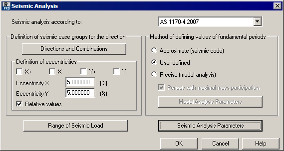

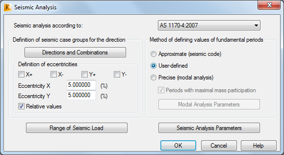

Seismic Analysis Parameters (Static)
To perform the seismic static analysis, select Seismic (Equivalent Lateral Force Method) option in the New Case Definition dialog.
You can select the seismic analysis according to the following codes: Australian Code AS 1170-4:2007, US code ASCE 7-10 / IBC 2009, EC 8 1998-1:2005.
Eccentricities on particular directions depend on directions and combinations settings. Mass eccentricity are defined for all floors, as an absolute length value or in relation to the dimension of floor.
To define values of fundamental period, the following methods are available:
In the lower part of the dialog Range of Seismic Load and Seismic analysis parameters buttons are located.
Note: The contents of the seismic analysis dialog differ depending on the method of defining values of fundamental period and selected code.
