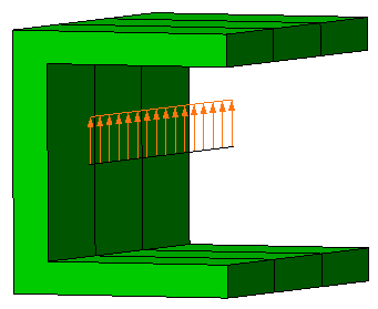

(a) Beam element with loads. A beam element mesh is simply a straight line; the cross sectional properties are treated analytically.
(b) With 3D Visualization active, the actual cross sectional shape is shown. Note how the loads are still shown on the original elements.
