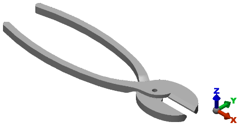

  2. Ensure the analysis type is set to Linear Static Stress with Linear Material Models and click OK. The model opens in the FEA Editor environment as shown below.
