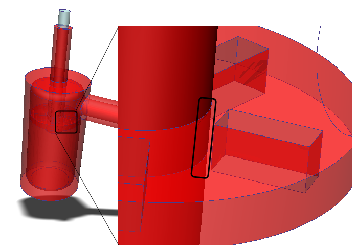

The following model of a hydraulic valve has an extremely tiny clearance that prevents a mesh from generating successfully using the default settings:

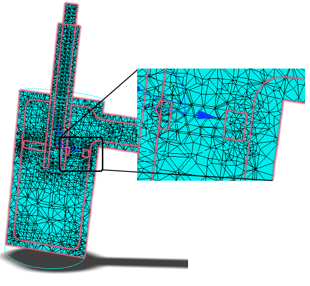

After some trial and error, it was discovered that the mesh generates successfully if Mesh Enhancement is turned off. This is obviously not ideal because no flow will be computed through the small gaps:

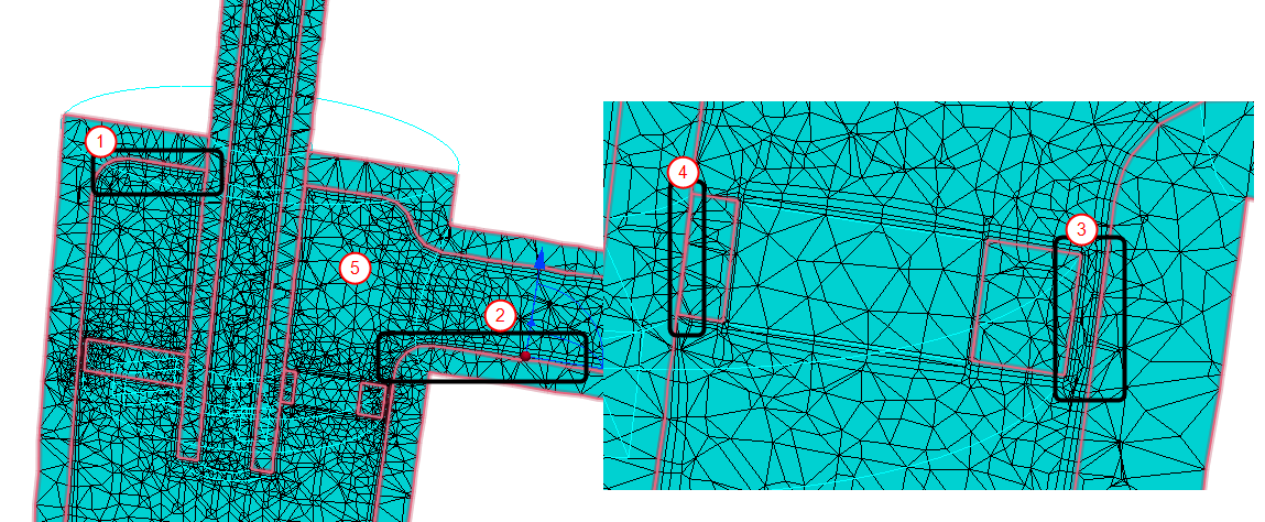

The Volume growth rate was modified, and Surface Refinement and Gap Refinement were invoked with the default settings. Mesh Enhancement is also enabled.
There were several important results:
