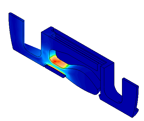

In this step, we examine the von Mises Stress values on the spring clip.

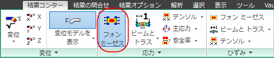

Click von Mises from the Stress panel to display stress on the assembly.
You should see this...

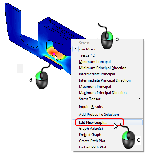

Plot the stress at this location:
Select a node near the red high-stress area. It doesn't matter if you don't select the most highly stressed node. We will specify the desired node number while creating the graph. (This is step 'a' in the figure that follows.)
(b) Right-click anywhere in the display area.
(c) Select the Edit New Graph command.

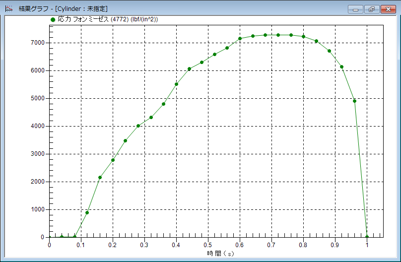

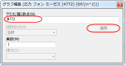

Enter the recorded node number in the Nodes Graphed field and click Apply.
Note the time step at which the maximum stress occurs. In this case, it is time step 18 (0.72 second).
