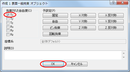

1. Click Setup Constraints General Constraint.

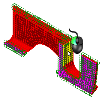

2. On the buckle part, select the surface perpendicular to the X-axis, as shown:
3. Check Tx, and click OK.

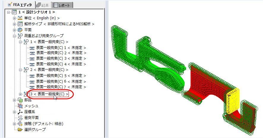

What it should look like…
