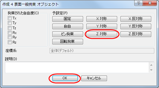

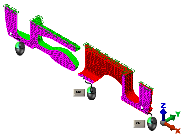

Z-Axis Symmetry:
2. Click Setup Constraints General Constraint.
3. Select the first Z-axis symmetry surface, hold Ctrl, and select the other three:
4. Click Z Symmetry, and OK.

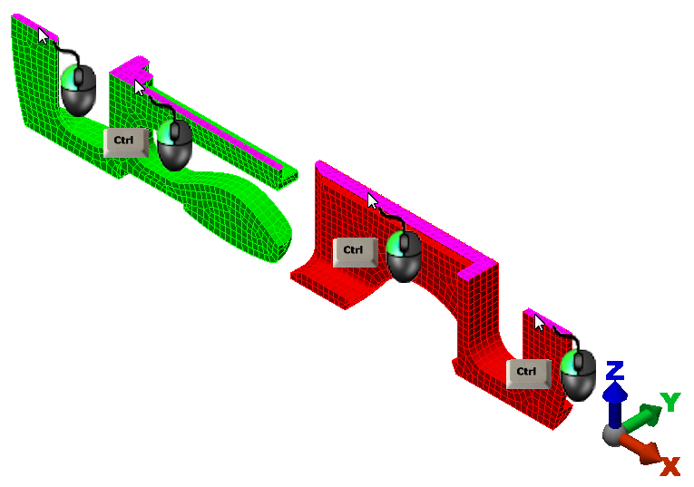

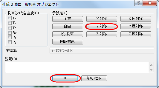

Y-Axis Symmetry:
5. Click Setup Constraints General Constraint.
6. Select the first Y-axis symmetry surface, hold Ctrl, and select the other two:
7. Click Y Symmetry, and OK.

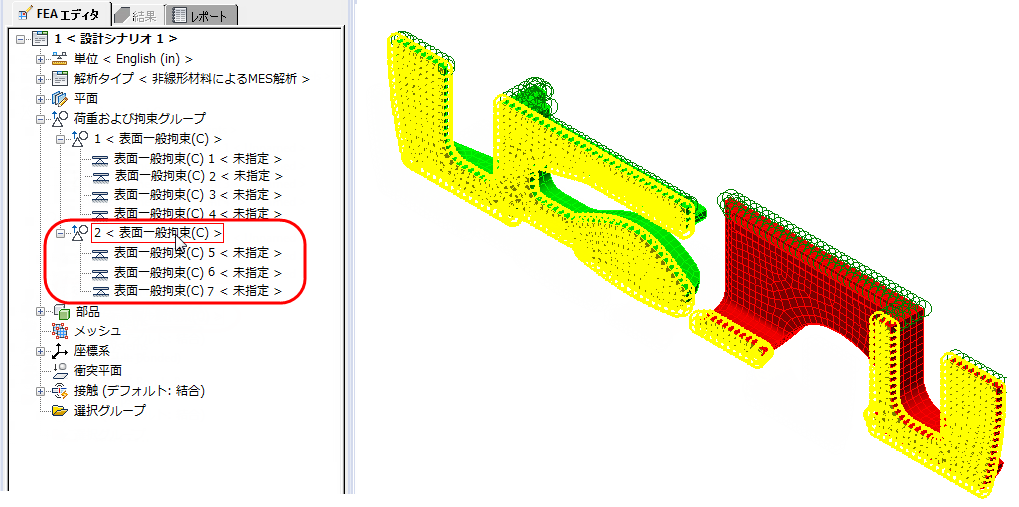

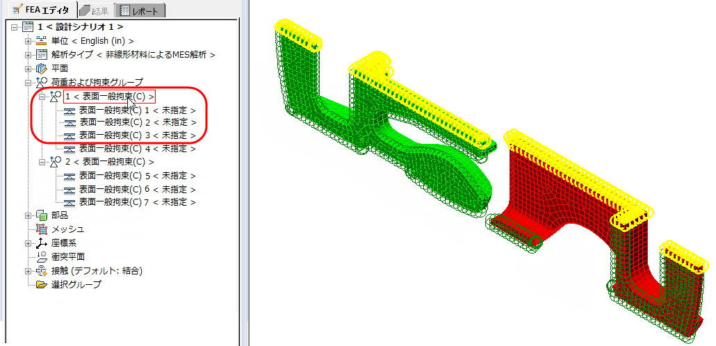

What it should look like…
