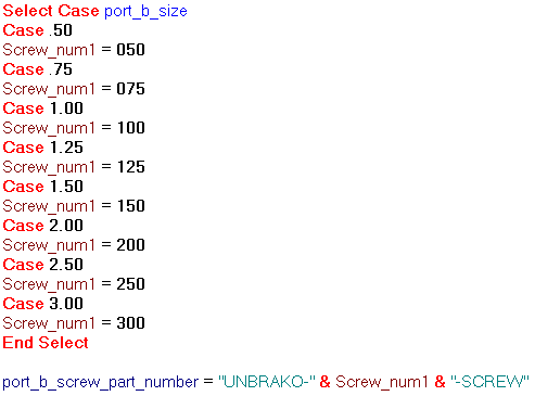

Select Case port_b_size Case .50 Screw_num1 = 050 Case .75 Screw_num1 = 075 Case 1.00 Screw_num1 = 100 Case 1.25 Screw_num1 = 125 Case 1.50 Screw_num1 = 150 Case 2.00 Screw_num1 = 200 Case 2.50 Screw_num1 = 250 Case 3.00 Screw_num1 = 300 End Select port_b_screw_part_number = "UNBRAKO-" & Screw_num1 & "-SCREW"

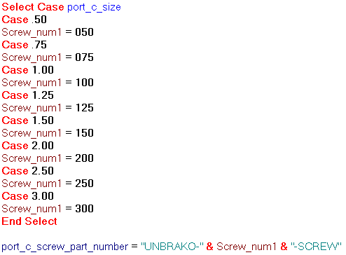

Select Case port_c_size Case .50 Screw_num1 = 050 Case .75 Screw_num1 = 075 Case 1.00 Screw_num1 = 100 Case 1.25 Screw_num1 = 125 Case 1.50 Screw_num1 = 150 Case 2.00 Screw_num1 = 200 Case 2.50 Screw_num1 = 250 Case 3.00 Screw_num1 = 300 End Select port_c_screw_part_number = "UNBRAKO-" & Screw_num1 & "-SCREW"
