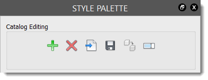

Style catalogues are collections of styles by feature class. You can add, delete, copy, or rename individual styles or entire style catalogues. You can also import or export style catalogues in a .STYLES.JSON format.
Click
to display the Style Palette.
Icon | Objective | Description |
Add New Style Catalogue |
Add a new style catalogue to the Style Palette for the desired feature class. |
Delete Selected Style Catalogue |
Note: To restore a deleted catalogue, import it.
Import Style Catalogue From File |
Import style catalogues in .STYLES.JSON format. If the file you specify is not compatible with the style category, it can not be added. |
Save Selected Style Catalogue |
Specify a location to export the selected style catalogue in a .STYLES.JSON format. |
Copy Selected Style Catalogue |
All styles from the original catalogue are copied into the new catalogue. |
Rename Selected Style Catalogue |
Enter a new name for the selected style catalogue. |

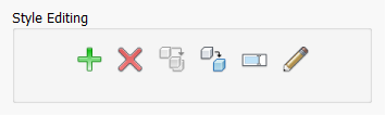

Add New Style |
Add a new style to the current style catalogue and choose its properties. You can also add a 3D model style or a material style to a style catalogue. |
Delete Selected Style |
Delete a selected style from the current style catalogue. |
Copy Selected Style To Another Catalogue |
Copy a style from one catalog to another. You can only copy styles into catalogues for the same feature class. |
Copy Selected Style to Current Catalogue |
Duplicate the selected style in the current catalogue, for example, to create a new style based on an existing one. |
Rename Selected Style |
Enter a new name for the selected style. |
Edit Selected Style |
Open the Style Editor and edit the properties of the selected style. See About Editing Styles. |
Click to adjust the size of the previews in a style catalogue. Move the slider to make the preview images larger or smaller. Your changes affect only the current tab.
