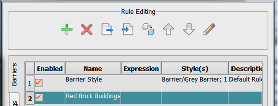

Style Rules use expressions to specify criteria that determine which styles will be applied to individual features in a feature class, based on the values of a data source property or model property you specify.
- Click
- In the Style Rules Panel, click the tab for the desired feature class to style. The tabs are on the left side of the Style Rules panel. For example, to create a rule for buildings, click the Buildings tab.
- Click
to create a new style rule. When prompted, enter a name for this style rule, for example, "Red Brick Buildings." After clicking OK, the new style name appears in the Rule Editing window.
- Select the new style rule and click
or double-click it to open the Rule Editor. Optionally, enter a description for the style.
- Click
under the Expression field. In the Create Filter Expression dialogue box, create an expression to filter the features you wish to style, then click OK. Note: If you don't create a filter expression for the Style Rule, the Style Rule you create will apply to the entire feature class.
- In the Rule Editor, click
to display the Select Style dialogue box. Select the style you want. Features that meet the criteria of the expression you created for this style rule will use the style you specify.
- When you're finished with this rule, click OK.
