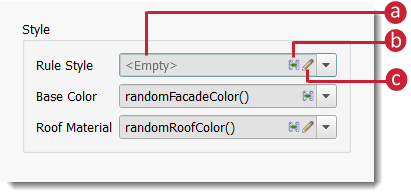

Use the Rule Style property to specify a default style for imported data, or map one property from the original data source to the Rule Style model property and create Style Rules for each property value.
to expand the drop-down list and select a data source property to specify that property as a rule style. b. Click
to create an expression to filter the Rule Style property you specify.
c. Click
to open the Style Chooser and select a default style to apply to all the feature(s) in the feature class. You can create Style Rules to override the default Rule Style using another model property field such as Manual Style.
to open the Style Rules panel.
in the Style Rules panel to add a new style rule. Type a name for the new style rule and press OK.
in the Expression field to open the Expression Editor and enter the desired filter expression. For example, input BUILDING_ID = Downtown Hospital Complex OR BUILDING_ID = Uptown Hospital Complex to select the Downtown OR Uptown Hospital Complex if your original data source contains those values for the BUILDING_ID property. Press OK.
In the Styles section of the Rule Editor to assign a style (such as "Facade/Concrete & Glass/Elodie") to the features specified by the expression.
