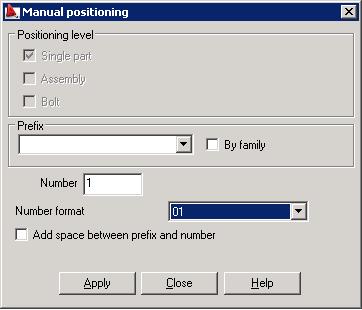

Use this option to assign a position manually.
To begin assigning positions manually, open the Manual positioning dialog from:
Options in this dialog are identical as for automatic positioning. For details concerning these options see the description of the General tab in the Automatic positioning dialog.
To assign a position manually:

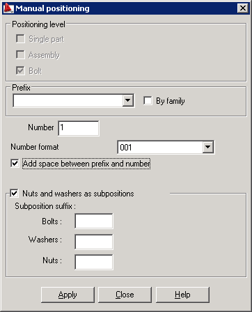

If a bolt (or bolts) is selected, the dialog as shown in the image below displays.
It includes the additional option Nuts and washers as subpositions. Details concerning this option are provided in the description of Numbering for automatic positioning.
