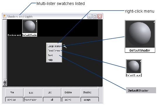

The title bar indicates the type of swatches that are listed in the Multi-lister. It also lets you control the display of swatches in the Multi-lister (text, small swatches, large swatches), and lets you close, track, and minimize/maximize the Multi-lister window.
There are five different types of swatches used in the Multi-lister: environment, shader, texture, layered shader, and light.
These five types of swatches are used to represent:

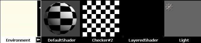

Swatches are listed in the following order: the environment, shaders, lights. Shaders and lights are listed alphabetically by name. Textures are listed next to the environment, shader, or light that they are mapped to.

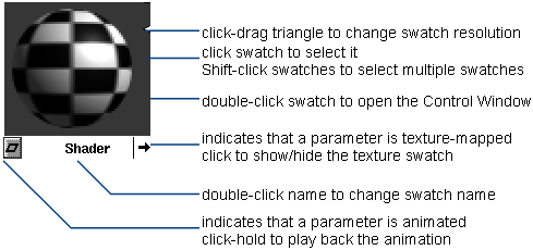

All swatches consist of an image and a frame. The image represents the appearance of the environment, shader, texture, or light. The frame contains the swatch name and any icons.
The type of swatch image and the way that you use the swatch are different for different swatch types. All swatches, however, share the following features.
You can select a swatch by clicking on it. You can select several swatches by
-clicking on them. By double-clicking a swatch, you open its Control Window. You can then edit any parameter for that particular environment, shader, texture, or light. Use the control window
You can edit the swatch name by double-clicking on the name and typing a new name. You can change the resolution of the swatch’s image by click-dragging the white triangle on the right side of the swatch either up (higher resolution) or down (lower resolution).
If an environment, shader, texture, or light has a texture mapped to one of its parameters, the swatch will have an arrow in its bottom right corner. By clicking on this arrow, you can toggle the display of the texture in the Multi-lister.
If you have animated a parameter of an environment, shader, texture, or light, the swatch will have a diamond in its bottom left corner. By click-holding on this diamond, you can play back the animation of the swatch.

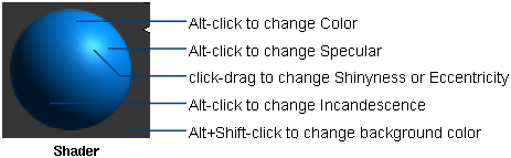

A shader swatch uses a sphere to represent the appearance of a surface. By
-clicking (Windows) or
-clicking (Mac) on different parts of the sphere, you can open the Color Editor and edit the shader’s Color, Specular, or Incandescence settings. (By
-clicking (Mac) on the background, you can open the Color Editor and edit the shader icon background color.) By click-dragging on the sphere’s highlight, you can interactively edit the shader’s Shinyness or Eccentricity value.
The shader swatch is only a preview image and may not exactly correspond to the appearance of the shader in a rendered image.

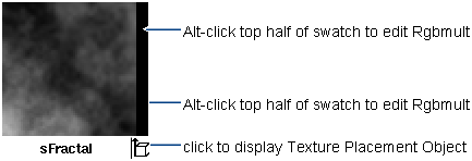

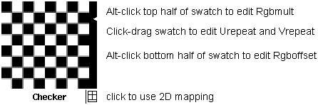

A surface texture swatch displays the two-dimensional texture. By
-clicking (Mac) on the top half of the swatch, you can open the Color Editor and edit the texture’s Rgbmult setting. By
-clicking (Mac) on the bottom half of the swatch, you can open the Color Editor and edit the texture’s Rgboffset setting. By click-dragging anywhere in the swatch, you can interactively edit the texture’s Urepeat and Vrepeat values.
A surface texture swatch has two texture mapping symbols in its bottom right corner. By clicking on one of these symbols you activate either 2D mapping or 3D mapping.
See Use 3D mapping to position a texture on a surface.
The Stencil texture appears black in the Multi-lister until you specify its Image.
The File texture appears black with a small question mark (?) icon until you specify its Image. If the Multi-lister cannot find a File texture’s image file, the File texture appears with both large and small question mark icons.
A layered shader represents the combination of shaders that have been layered onto a surface. The appearance of these layers is rendered onto a sphere swatch in the multilister. Click the swatch to open the layered shader editor.
A new, empty layered shader appears black, because the layers are empty. To add shaders to a layered shader, select one or more shaders from the Multilister window, then click Add. You can select multiple shaders by pressing the
key while you select shaders.
To remove shaders from a layered shader, select one or more of the listed shaders in the Layered Shader editor, then click Remove. You can select multiple shaders by pressing the
Use the
in the Layered Shader editor to rearrange the layers.
The window shows the layers of shaders that have been applied to a simple sphere. You can now assign this layered shader to other objects.
An environment or solid texture swatch uses a two-dimensional pattern to represent the three-dimensional texture. By
See Apply 3D environments and Apply solid textures.
An environment or solid texture has a texture placement symbol in its bottom right corner. By clicking on this symbol you can display the texture’s Texture Placement Object in the modeling windows.
The Ball, Cube, Sphere, Projection, and Volume textures appear black in the Multi-lister until you specify an image file or series of image files for them. The sCloud texture always appears black in the Multi-lister; the shader it is mapped to displays the actual texture.

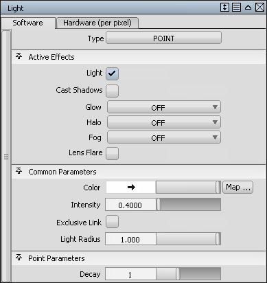

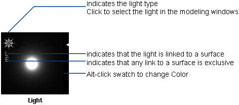

A light swatch represents a light as viewed from 10 units away with a 20 degree field of view. By
-clicking (Mac) the swatch you can open the Color Editor and edit the light’s Color parameter.
A light swatch has a light type symbol in its top left corner. If the light has a force component, the light swatch will also have a force type symbol. If the light is linked to a surface, the light swatch will also have an L symbol. If a light’s link to a surface is exclusive, the light swatch will also have an E symbol.
See Create a light.

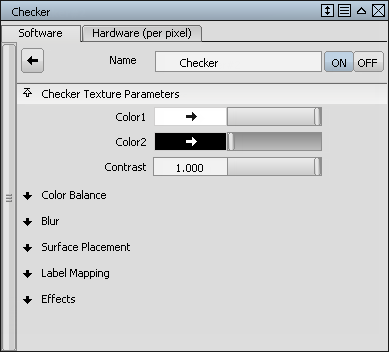

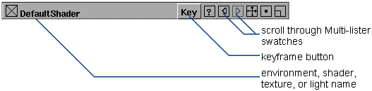

The Control Window is sometimes referred to as the Environment Editor, Shader Editor, Texture Editor, or Light Editor.

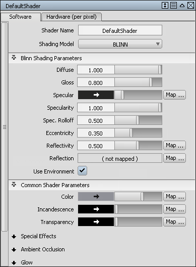

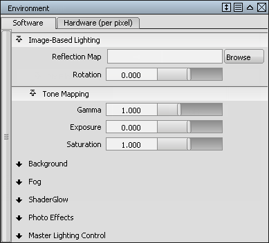

The Control Window is the interface that you use to edit shaders, textures, lights, and the environment. You can also use the Control Window to access the Color Editor.
The Control Window contains a list of parameters for the selected swatch in the Multi-lister, and allows you to edit these parameter values or settings interactively. There are four different types of Control Window: environment, texture, shader, and light.

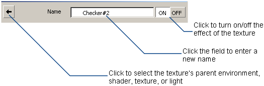

The title bar indicates the name of the active environment, shader, texture, or light in the Multi-lister. It also contains buttons or icons that let you set a keyframe for a parameter, or scroll through the Multi-lister swatches.

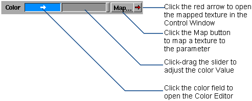

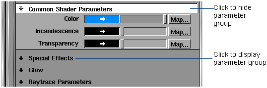

Parameters control the appearance of shaders, textures, lights, and the environment. Each parameter has a name, which describes the parameter, and a field, which specifies (and allows you to change) the parameter’s setting or value. The Control Window contains several different types of fields: name fields, file name fields, toggle fields, menu fields, numeric fields, and color fields.
All the parameters are displayed on the Software tab; a selection of applicable parameters is displayed on the Hardware tab. The hardware tab is labelled either Per Pixel or Per Vertex, depending on the Shading Method selected for WindowDisplay > Hardware Shade
Name fields let you change the name of a shader or texture by clicking in the field and typing a new name. Textures also have an arrow button on the left side of the name field, and ON and OFF buttons on the right side of the name field. The arrow button lets you select the texture’s parent swatch in the Multi-lister (that is, the environment, shader, texture, or light that the texture is mapped to). The ON and OFF buttons let you turn the effect of the texture on or off.
File name fields let you specify a path and file name by clicking in the field and typing a file name. File name fields also have a Browse button on the right side of the field. You can click the Browse button to select a file using the File Requestor.
Toggle fields let you set a parameter ON or OFF.

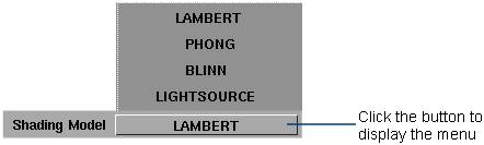

Menu fields let you select from a list of menu options by clicking the mouse on a menu button, and then releasing the mouse on the desired option.

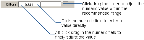

Numeric fields let you enter a number using either the keyboard or a slider beside the field. (You can also hold down the
(Windows) or
(Mac) key and drag the mouse in the numeric field to make fine adjustments to the value.) Each numeric field has a valid range (the range of values you can enter by typing in the field) and a slider range (the range of values you can enter using the slider). The slider range represents the recommended range of values for that parameter. The valid range is negative infinity to positive infinity for all numeric fields unless otherwise stated.
Some numeric fields also have a Map button (for example, Reflectivity).
Color fields let you specify the color value by using the slider, specify the color by clicking the color field and opening the Color Editor, or map a texture to the parameter by clicking the Map button. If you map a texture to a color field, a red arrow button appears to the right of the Map button. By clicking this red arrow you can open the Control Window for that texture.
In the Control Window, parameters are organized in groups. You can display or hide a parameter group by clicking on the group name.

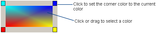

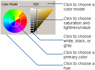

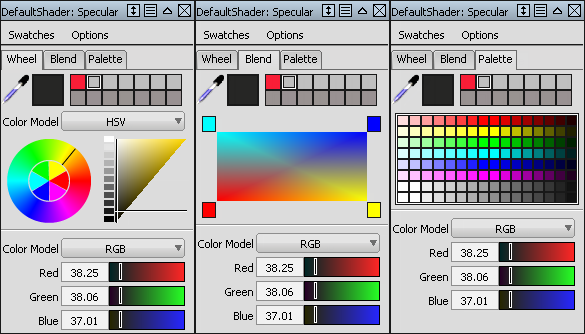

The Color Editor is the interface that you use to change the colors of environments, shaders, textures, and lights by that have a color field in the Control Window.
The color editor has three tabs that enable you to choose color based on your preferred method: a color wheel and triangle; a box for blending between four colors, and a palette of colors.

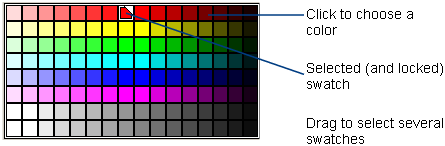

Resets the Swatchesto their default setting (except for locked swatches).
Re-arranges the Swatches so all empty swatches are in the bottom right corner of the Swatches area.
When several swatches in the Swatches area are selected, Ramp Selected creates a ramp of swatches gradually blending between the color of the first selected swatch and the color of the last selected swatch.
Locks the selected swatches in the Swatches area so you cannot delete them (by choosing Swatches > Delete Selected or Swatches > Reset to Default). A locked swatch has anwhite triangle in the upper right corner.
Unlocks the selected swatches in the Swatches area so you can delete them (by choosing Swatches > Delete Selected or Swatches > Reset to Default).
Sets the RGB and CMY slider ranges to 0 to 255.
Sets the RGB and CMY slider ranges to 0 to 1.
Sets the RGB and CMY slider ranges to 0 to 100.
A history of the last fourteen colors you have used is automatically stored in a series of swatches along the top of the Color Editor. To choose a color from the history, click its swatch.

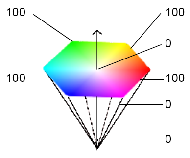

The Sliders let you choose a color by dragging sliders or setting values for each color component.
Controls whether the sliders use the HSL, HSV, RGB, or CMY color model.
See Color Models.
Let you choose a color by setting values for:
You can choose the range for RGB and CMY sliders from the Options menu.
The active color swatch indicates the active color. The active color swatch updates interactively as you adjust the active color or choose a new color.
Positioned directly beside the active color swatch is a color picker. Click this icon to change the cursor to a medicine dropper. Click the canvas to pick up a color from the active layer.
This area lets you choose a color using a color wheel and triangle.
Controls whether the color triangle uses the HSL or HSV color model.
Lets you choose:
Lets you choose:
white, black, or gray by clicking on the column of swatches
a saturation and lightness/value by clicking in the triangle.
The blending box represents a blend of four colors (the colors in the four corner squares of the palette). You can use the blending box to select a color by clicking or dragging anywhere within the box.
You can change the corner colors of the box by setting the current color (for example, using the sliders), and then clicking a corner square of the blending box.
The Swatches area lets you choose a color from a customizable collection of color swatches.
The Color Editor Picker and Sliders can represent color using various color models:
The HSL color model uses dimensions that are familiar to artists to specify colors: hue, lightness, and saturation. These three dimensions are represented by a double-hexcone.
There is one main difference between the HSL and HSV color models. In the HSV color model, both fully saturated colors (for example, pure red) and white have a value of 100%. In the HSL color model, fully saturated colors have a lightness (value) of 50% and white has a lightness (value) of 100%. In the HSL color model, pure white is perceived to be “lighter” than fully saturated colors (for example, pure red).
Hue is the quality humans use to distinguish one color from another. For example, red, green, and yellow are hues. In the HSL double-hexcone, hue is measured by the angle around the vertical axis. Red is at 0°, green at 120°, and blue at 240°.
Saturation is the quality that distinguishes a strong color from a weak one. At 100% saturation, the hue is perceived at its strongest; 0% saturation is grayscale — there is no hue, only black, white, or a shade of gray. In the HSL double-hexcone, 100% saturation is at the perimeter of the hexagon, and 0% saturation is at the central axis of the double-hexcone.
Lightness distinguishes light colors from dark ones. Black has a lightness of 0, and white has a lightness of 1 (and a saturation of 0). The bottom point of the double-hexcone has 0 lightness; this increases along the axis of the double-cone to 1 at the top point.
If the Lightness = 0, then the color is black, regardless of the values for hue and saturation. Similarly, if Lightness = 1, then the color is always white.
The HSV color model uses dimensions similar to the HLS color model: hue, saturation and (brightness) value. These three dimensions are represented by a single hexcone.
Hue is the quality humans use to distinguish one color from another. For example, red, green, and yellow are hues. In the HSV hexcone, hue is measured by the angle around the vertical axis. Red is at 0°, green at 120°, and blue at 240°.
Saturation is the quality that distinguishes a strong color from a weak one. At 100% saturation, the hue is perceived at its strongest; 0% saturation is grayscale — there is no hue, only black, white, or a shade of gray. In the HSV hexcone, 100% saturation is at the perimeter of the hexagon, and 0% saturation is at the central axis of the hexcone.
Value is the brightness value; it distinguishes light colors from dark ones. Black has a brightness value of 0%, and white has a brightness value of 100% (and a saturation of 0%). The point of the hexcone is 0% value; this increases along the axis of the cone to 100% at the top surface.
If the Value = 0, then the color is black, regardless of the values for hue and saturation. In other words, the absence of light is black.

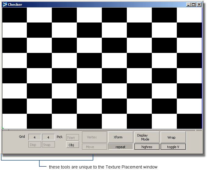

The Texture Placement window is sometimes referred to as the Texture Space Editor.
The Texture Placement window displays a texture that is mapped to a surface, and allows you to position the texture interactively. The two dimensions of this window (S and T) represent the two parametric dimensions of the active surface (U and V). A texture mapped to the active surface is therefore displayed in the Texture Placement window relative to the surface.
Please note that not all texture parameters are available when using textures within Shapes when sketching or painting.
The buttons at the bottom of the Texture Placement window allow you to edit the position and orientation of the texture relative to the surface.
The title bar contains standard dolly and track icons, and full/half/resize, minimize, and close icons. The buttons and menus located along the bottom of the window let you interactively edit all Surface Placement and Label Mapping parameters. There are also some additional tools along the bottom of the window that are unique to the Texture Placement window.
The Grid buttons allow you to display a grid in the window, specify the size of the grid, and enable snapping of texture vertices to the grid.
Displays a light grey grid in the window. The numeric field above the Disp button controls the number of vertical grid lines (representing U in parametric space), and the numeric field above the Snap button controls the number of horizontal lines (representing V in parametric space). Click in either of these fields to change the number of grid lines.
Enables snapping of texture vertices to the nearest grid location when you perform texture vertex transformations.
The Pick buttons, Obj (Object) and TVert (Texture Vertices) allow to you to select geometry or vertices in the modeling window, and load them into the Texture Placement window. Picking geometry or vertices in the modeling window is similar to using the Pick > Point Types > CV
tool:

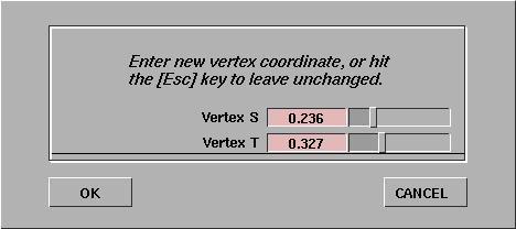

Lets you enter numeric S and T values to re-position the selected vertex. When you select Set Vertex, the following dialog box is displayed.
You can also select the Set Vertex function by moving the mouse pointer over the Texture Placement window and pressing the S key.

Dollies the display in the Texture Placement window so that the placement object (representing the surface) fills as much of the window as possible.
The Display Mode tools let you change the way the surface and texture are displayed in the Texture Placement window. The default display mode is Picture.
Displays the surface as a white outline, the texture as a red outline, and the grid as blue lines.
Displays the texture as a color image against the shader color, unless you are using an Transform function. During Transform operations, the display changes to Line Only mode. When the Transform operation is completed and the mouse button is released, the texture is displayed as a color image again.
Displays the texture as a color image at all times.
Displays the texture as a high resolution color image at all times. High Res. mode may be slower than other display modes.
The Wrap tools let you repeat the texture pattern outside of its coverage area.
Wraps the texture outside of its coverage area in the V parametric direction. This tool controls the texture’s Vwrap setting.
Wraps the texture outside of its coverage area in the U parametric direction. This tool controls the texture’s Uwrap setting.
The Model View tools let you change the type of view in the modeling window.
Displays the texture on the wire frame of the active surface if the texture is mapped to that surface. This tool activates 3D mapping.
Displays the active surface in normal wire frame view. This tool toggles the modeling windows out of Shaded Wire mode.
