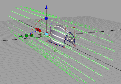

A new visualization tool enables you to see your model as if it were surrounded by long fluorescent light fixtures. The linear reflection tool is only available in hardware shade mode.
If turned on, the tunnel is represented with green lines. It’s useful to turn the display on when creating the reflection band display.
