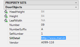

- Select the object(s) for which you want to add a manual property or field, right-click, and click Properties.
- On the Properties palette, click the Extended Data tab.
Note: If no property set data appears, no property sets are attached to the objects.
- Enter a value for a manual property.
| If you want to…  |
Then  |
| specify an alphanumeric value  |
select the property, and enter the value.  |
| insert a field  |
right-click in the current value for the property, and click Insert Field. Select a field from one of the available categories, specify the desired format, and click OK.  |
