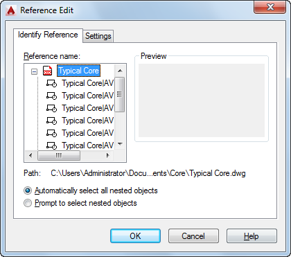

- Double-click the xref in your drawing.
- In the Reference Edit dialog box, on the Identify Reference tab, select Prompt to select nested objects, and click OK.
- Select the object in the xref, and press Enter.

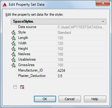

- Next to Property Sets From Style, click
 (Edit style property set data).
- On the Edit Property Set Data worksheet, enter new values for the property set data, and click OK.
