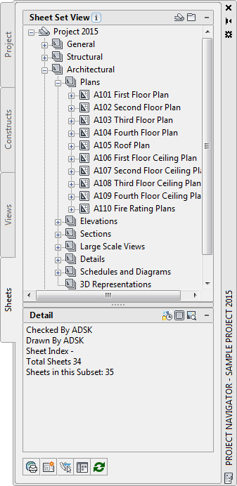

When you create a new project, a unique sheet set is created for this project. The project sheet set is displayed on the Sheets tab of the Project Navigator.
Project sheet set in AutoCAD Architecture Project Navigator
Only one sheet set can be associated with a project. You cannot change the sheet set for an existing project, but you can change its properties.
