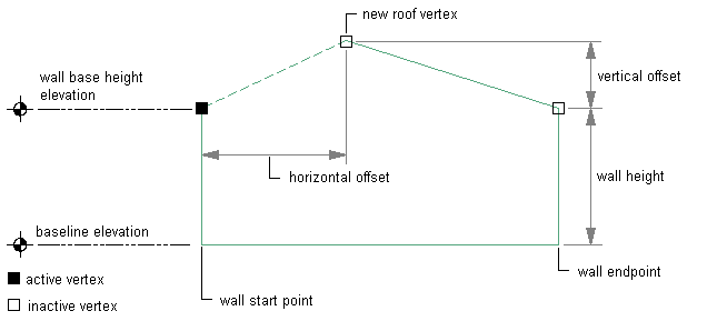

The following illustration shows modifying the roof line of a wall by adding a vertex.
Modifying a roof line of a wall by adding a vertex

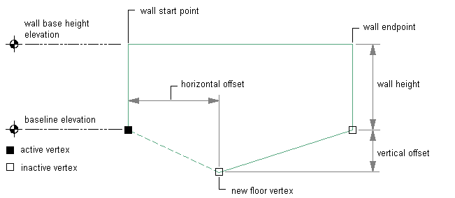

The following illustration shows modifying the floor line of a wall by adding a vertex.
Modifying a floor line of a wall by adding a vertex
