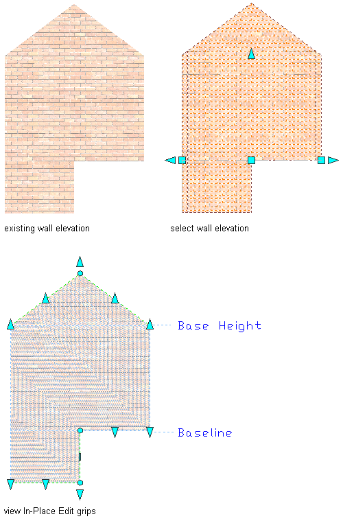

Use this procedure to edit the geometry of the roof line or the floor line of a wall:
You can also edit the roof line and the floor line on the Roof/Floor Line worksheet on the Properties palette.
Viewing Edit In Place Wall Elevation Grips
A temporary profile is created for you to edit the geometry of the roof line and floor line.
Wall Elevation Edit In Place Grips

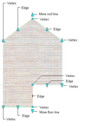

| If you want to … | Then … |
| add a gable to the roof line or the floor line | select the profile, and click ![]() . |
| add a step to the roof line or the floor line | select the profile, and click ![]() . |
| change the shape of the roof line or the floor line | select the profile, and use Move Roof Line, Move Floor Line, Vertex, and Edge grips to adjust the shape. |
| add vertices to the roof line or the floor line | select the profile, and click ![]() . |
| remove vertices from the roof line or the floor line | select the profile, and click ![]() ![]() |
| project the roof line or the floor line to a polyline | select the profile, and click ![]() . |
| project the roof line or the floor line to another object, such as a stair or a roof | select the profile, and click tab ![]() . |
| reverse the roof line or the floor line | select the profile, and click ![]() . |
| restore the roof line to the base height of the wall, or restore the floor line to the baseline of the wall | select the profile, and click ![]() . |
