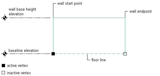

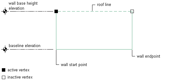

You can modify the roof and floor lines of a wall to create a non-rectangular wall.
Modifying the roof line of a wall
Modifying the floor line of a wall
