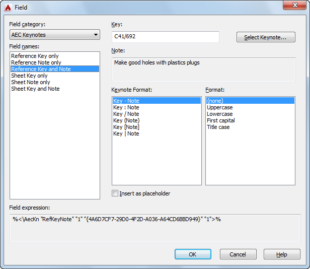

Use this procedure to select a keynote field into a drawing.
| If you want to… | Then… |
| insert a keynote field into a text element | see Inserting Fields in AutoCAD Text elements. |
| insert a keynote field into a multiline text (mtext) element | see Inserting Fields in AutoCAD Multiline Text. |
| insert a keynote field into an AutoCAD table cell | see Inserting Fields in AutoCAD Table Cells. |
| insert a keynote field into an attribute definition | see Inserting Fields in Attributes. |
| insert a keynote field into a property set definition | see Inserting Fields in Property Set Definitions. |
| insert a keynote field into an object property | see Inserting Fields in Object Properties. |
| insert a keynote field into an object style | see Inserting Fields in Style Properties. |
Under Field Names, all keynote-related fields are displayed.
