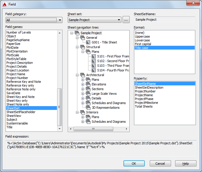

Use this procedure to select a sheet set field to insert into a drawing.
| If you want to… | Then… |
| insert a sheet set field into a text element | see Inserting Fields in AutoCAD Text elements. |
| insert a sheet set field into a multiline text (mtext) element | see Inserting Fields in AutoCAD Multiline Text. |
| insert a sheet set field into an AutoCAD table cell | see Inserting Fields in AutoCAD Table Cells. |
| insert a sheet set field into an attribute definition | see Inserting Fields in Attributes. |
| insert a sheet set field into a property set definition | see Inserting Fields in Property Set Definitions. |
| insert a sheet set field into an object property | see Inserting Fields in Object Properties. |
| insert a sheet set field into an object style | see Inserting Fields in Style Properties. |
Under Field Names, all sheet set-related fields are displayed.
If necessary, browse to a different sheet set.
