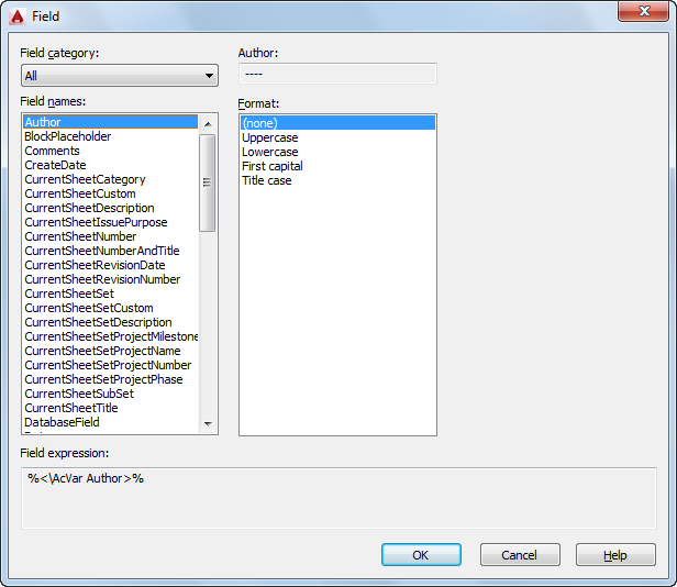

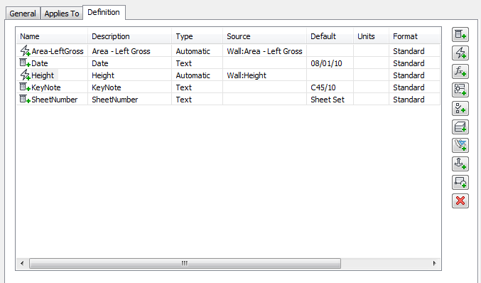

Use this procedure to insert a field in a property set definition.
When you insert a field in a property set definition, the field will appear in the properties of any object or object style that has the property set attached.

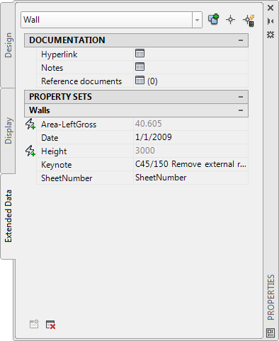

Wall properties with keynote, date, and sheet number fields
| If you want to insert a … | Then… |
| date/time, document, hyperlink, object, system variable, Diesel expression, or plot field | see “Use Fields in Text” in AutoCAD help. |
| project field | see Selecting a Project Field. |
| sheet set field | see Selecting a Sheet Set Field. |
| keynote field | see Selecting a Keynote Field. |
| database field | see Selecting a Database field. |
