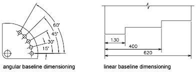

Creates a linear, angular, or ordinate dimension from the baseline of the previous or selected dimension.
Button
The default spacing between baseline dimensions can be set from the Dimension Style Manager, Lines tab, Baseline Spacing (DIMDLI system variable).
