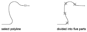

Specifies that the X axes of the inserted blocks be tangent to, or collinear with, the divided object at the dividing points.
Aligns the blocks according to their normal orientation.
The illustration shows an arc divided into five equal parts using a block consisting of a vertically oriented ellipse.
