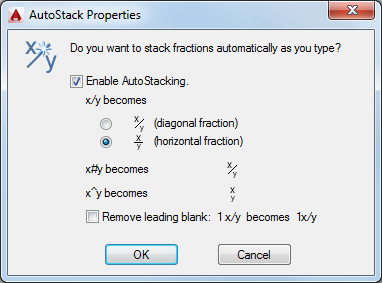

Sets the defaults for automatically stacking characters.
The following options are displayed.
Automatically stacks numeric characters entered before and after the carat, slash, or pound character. For example, if you type 1#3 followed by a nonnumeric character or space, the text is automatically stacked as a diagonal fraction.
Converts the slash character to a diagonal fraction when AutoStack is turned on.
Converts the slash character to a horizontal fraction when AutoStack is on.
Removes blanks between a whole number and a fraction.
