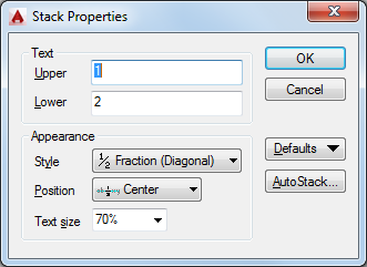

Edits the text, stack type, alignment, and size of stacked text.
To open the Stack Properties dialog box, select the stacked text, right-click, and click Stack Properties on the shortcut menu.
You can edit the upper and lower text separately. The Appearance options control the stack style, position, and text size of the stacked text.
The following options are displayed.
Changes the upper and lower numbers of a stacked fraction.
Edits the number in the upper part or first half of a stacked fraction.
Edits the number in the lower part or second half of a stacked fraction.
Edits the style, position, or text size of a stacked fraction.
Specifies a style format for stacked text: horizontal fraction, diagonal fraction, tolerance, and decimal.
Specifies how fractions are aligned. Center alignment is the default. All stacked text in an object uses the same alignment.
Controls the size of the stacked text as a percentage of the size of the current text style (from 25 to 125 percent).
Displays the AutoStack Properties dialog box. AutoStack only stacks numeric characters immediately before and after the carat, slash, and pound characters. To stack nonnumeric characters, or text that includes spaces, select the text and choose Stack from the text editor shortcut menu.
