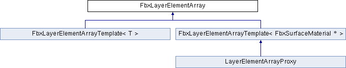

+ Inheritance diagram for FbxLayerElementArray:

int FindBefore ( int  pBeforeIndex,
T const &  pItem
) const
inline
Searches for one item before the specified index in the data buffer.
Parameters
pBeforeIndexThe specified index before which the searching begins
pItemThe value of the item for which to search, the searching begins before pBeforeIndex.
Returns
The index of the item found, -1 if not found.
Remarks
The index of the first item whose value equals pItem is returned.
Definition at line 747 of file fbxlayer.h.
747 { return FindBefore(pBeforeIndex, (const void*)&pItem, FbxTypeOf(pItem)); }
EFbxType FbxTypeOf(const FbxRefPtr &)
Definition: fbxlayer.h:315
int FindBefore(int pBeforeIndex, const void *pItem, EFbxType pValueType) const
Searches for an item before the specified index in the data buffer.
void CopyTo ( FbxArray< T > &  pDst)
inline
Copies the items in the data buffer to an array.
Parameters
pDstThe destination array where the items are to be copied.
Definition at line 753 of file fbxlayer.h.
754  {
755  T src;
756  T* srcPtr = &src;
757
758  pDst.Clear();
759  if (mDataType != FbxTypeOf(src))
760  {
762  return;
763  }
764
765  pDst.Resize(GetCount());
766  for (int i = 0; i < GetCount(); i++)
767  {
768  if (GetAt(i, (void**)&srcPtr, mDataType))
769  {
770  pDst.SetAt(i, src);
771  }
772  }
774  }
void Clear()
Reset the number of element to zero and free the memory allocated.
Definition: fbxarray.h:350
int GetCount() const
Returns the count of items in the data buffer.
void SetAt(const int pIndex, const T &pElement)
Set the element at given position in the array.
Definition: fbxarray.h:212
EFbxType mDataType
Definition: fbxlayer.h:791
bool GetAt(int pIndex, void **pItem, EFbxType pValueType) const
Returns the specified item's value.
bool Resize(const int pSize)
Inserts or erases elements at the end such that Size() becomes pSize, increasing capacity if needed...
Definition: fbxarray.h:297
void SetStatus(LockAccessStatus::ELockAccessStatus pVal) const
Definition: fbxlayer.h:782
void* GetDataPtr ( )
protected
void* GetReference ( int  pIndex,
EFbxType  pValueType
protected
void GetReferenceTo ( int  pIndex,
void **  pRef,
EFbxType  pValueType
protected
void SetStatus ( LockAccessStatus::ELockAccessStatus  pVal) const
inlineprotected
Definition at line 782 of file fbxlayer.h.
783  {
784  const_cast<FbxLayerElementArray*>(this)->mStatus = pVal;
785  }
FbxLayerElementArray is the base class for FbxLayerElementArrayTemplate, it provides lock handling an...
Definition: fbxlayer.h:325
void SetImplementation ( void *  pImplementation)
protected
void* GetImplementation ( )
inlineprotected
Definition at line 788 of file fbxlayer.h.
788 { return mImplementation; }
virtual void ConvertDataType ( EFbxType  pDataType,
void **  pDataPtr,
size_t *  pStride
protectedvirtual
Member Data Documentation
EFbxType mDataType
protected
Definition at line 791 of file fbxlayer.h.
The documentation for this class was generated from the following file:
