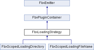

+ Inheritance diagram for FbxLoadingStrategy:
