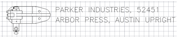

What happens to asset annotations in AutoCAD Factory?
Once a 3D layout is synced to AutoCAD Factory, annotations appear as block attributes in a separate text style called Factory_Annotation. The asset tag and descriptor are each assigned their own separate AutoCAD layer. The layer names are Factory_AssetTag and Factory_Descriptor, respectively.
You can use the standard AutoCAD block attribute editing commands like EATTEDIT, -ATTEDIT, and BATTMAN to edit the asset annotations. Control the visibility of the annotations with the ATTDISP command, or by turning layer visibility on/off or freezing the appropriate attribute layer. Use the FIND command to help you locate asset tag and descriptor text in the AutoCAD graphics window.
