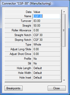

Connector breakpoints are used for setting up the graphical qualities of a connector and the connector end Nodes. They have to be set up for each pattern library, i.e. Rectangular, Round, and Oval. The Database displayed in this help file is used in CAMduct and ESTduct. This is because these programs display all settings for Manufacturing, Costing, and Drawing.
The screen example below is the Connectors Manufacturing view which is the second icon along the top.
The fields available for setting the breakpoints are:
Round and Oval Breakpoints are different in that they have more parameters these are:

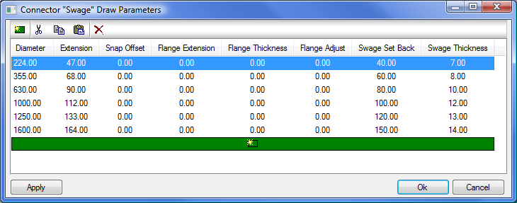

The Table supports Swage, Flange, Coupling and Spigot-Socket type of connectors. The Extension Column defines the length taken up by the connection. When defining Product Dimensions, the Extension dimension can be set to Auto. In which case the values are picked up from the assigned connector. The Table above shows a typical multi size set up for Round Duct Swage Connectors
Swage type

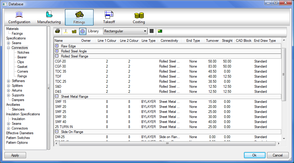

The screen example below is the Connector Drawing view which is the fourth icon along the top.
This part of the connector Database controls how the Connector is displayed.

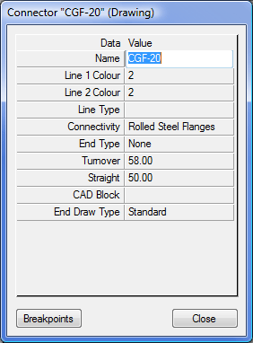

Double click on a connector within the Drawing view to display the option box below. This example is for a Rectangular pattern but the options listed below also cover Round/Oval patterns.
Line 1 Colour / Line 2 Colour - Controls the colours for the main two lines defining the connector. The basic colours available are based on AutoCAD colours and are as follows:
1- Red
2- Yellow
3- Green
4- Cyan
5- Blue
6- Magenta
7- Black
8- Dark Grey
9- Light Grey
0-White
There are other Gradient Colours that range from 10 to 249 which use a mixture of Tints and Hues, colour Range 250 - 255 are shades of Grey.
Line Type - Sets the line type that connector will use for rectangular connectors.
Connectivity - The basic rule for interconnectivity is used with the End Type being Male >< Female. If the End Type is set to None we check this Connectivity field for the same Group Name. Beyond these rules, any connector can connect without a mis-match prompt, if the connectors Connectivity column has the same name.
End Type - Defines the rules for Connector Matching when two Items are joined together. End types are commonly used for the coupling logic by allowing for coupling items, that have the same connectivity group, to be automatically assigned between pipe / fitting connections. Each connector can be assigned an End Type which controls what it is allowed to connect to with out generating a warning; as per the following:

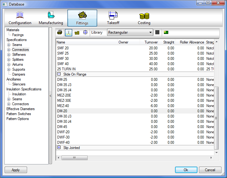

Turnover - This option can be used to control additional material added or removed onto the duct for Manufacturing purposes.
Straight - This option allows the user to add additional straight to an Item to allow for connectors.
CAD Block - If a block exists in the drawing with the name of the Block entered here + "-???" where ??? is the duct size, it will draw that block at the duct end associated with the connector. An Example of this is found in the Victaulic connectors shipped with the program.

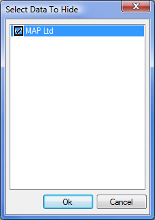

Filter Out non user Data
This enables the user to exclude any Non User data from the Database, this is usefull, for example, if you are working with Round Duct and you do not want to display all the Pipework Connectors that are supplied by the Manufacturer in their services.
