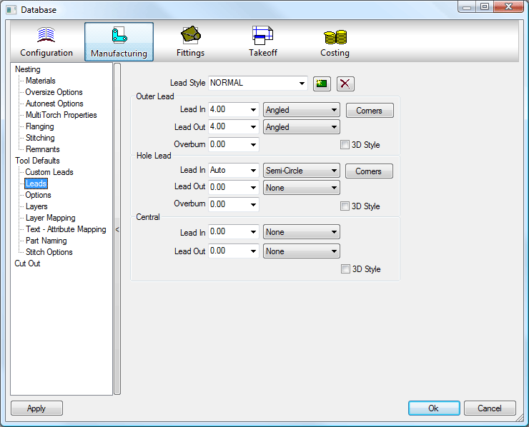

Leads are the pre-part and post-part cuts that ensure a smooth cut with no discernible start or end point. Lead styles are used when defining a part's cutting requirements in Profiler. The leads section allows for the editing of lead styles. Lead-in and lead-out lengths and types can be set for all types of islands. To access and amend these details Click on File Setup Database Manufacturing and select the Leads section or select the Database icon from the Utility Bar.
Lead Style
This allows for different styles to be created, you can give the style a descriptive name in this box. To create a new style click on the icon. Each style is composed of the elements below.

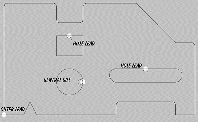

Outer Lead / Hole Lead / Central
The leads defined are given both a length in millimetres and a type.
Each lead in / out can be defined as a particular lead type or as a created custom lead. Lead In is the length of cut that is made before the development is started, this can be set as a value or set to Auto.

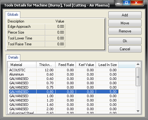

If Auto is used then the Lead length is taken from the value specified in the Installed Machines Tools database. This then allows the user to create Material Specific Lead sizes.
Lead Out is the length of cut that is made after the development is completed. Overburn is the distance that the path of the cutter goes back over itself. Below are some examples of the lead types available. Leads are shown in red. Islands are shown in black. This value can also be set to Auto and the parameter set in the Installed Machines Tools database.

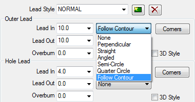

Perpendicular
A lead that intercepts the part at ninety degrees.
Straight
A lead that intercepts the part, usually on a corner, with no deflection angle - in other words it continues straight on to meet the part.
Angled
A lead that intercepts the island at a specific angle.
Semi-Circle
A lead that intercepts the island after first traversing a half circle of a defined radius.
Quarter Circle
A lead that intercepts the island after first traversing a quarter circle of a defined radius.
Follow Contour
This lead was developed for use with Router Cutting Systems.
Custom
A user-defined lead that is created in the Custom Leads section.
