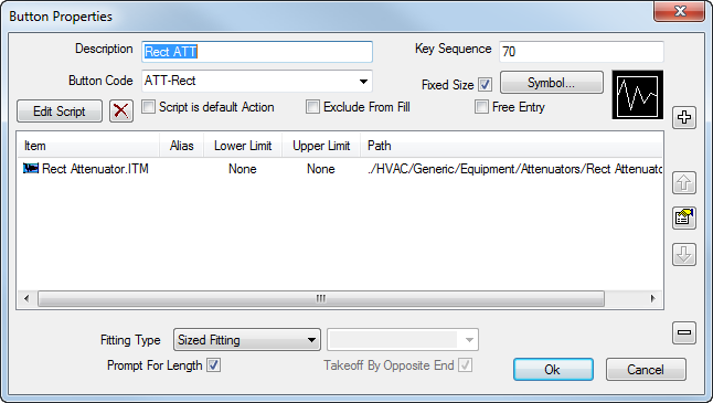

Accessing Button Properties
Select Button Properties from the Right Click menu that appears.
The most common and important options from this dialogue are as follows:
- Button Code: Requirement for detection of Design Line fill. Setting a unique code on a button will isolate items to fill the particular item in question. Sharing codes amongst similar buttons will perform the fill routine of the first button code in the service that shares the same name as the one placed into the Design Line. Buttons with no code cannot be filled in 3D (Coupling patterns are exceptions to this rule as these can be automated for entry using connectivity rules).
- Key Sequence: Used within Quick Takeoff and is for fast entry of buttons in particular relating to our Estimating software. Users can type the Key Sequence followed by the Enter key to bring up a particular item into view ready for takeoff. Key sequences are also used to map to the Digitizer template when using Digitizer takeoff.
- Symbol: Used for referencing/displaying a 2D image onto the Design Line which is visible to the user and applied to the Design Line layer (2D DXFs).
- Exclude from Fill: Skips the button from filling in 3D routines and attempts to fill the next item if sharing the same Button Code (Mapping).
- Fitting Type: Used to perform actions when placing buttons onto the active Design Line. More information below from the Fitting Types heading.
- Prompt for Length: Prompts the user with an entry field at the time of placement. This adapts the items length field (if unlocked and available) with the value entered for inclusion onto the line. The filled in item will have the length specified. Useful for Attenuators.

Sized Fitting : When applied to items such as Attenuators or Silencers, the size in the Design Line Takeoff, will be the size the Line fills this item with. For example, if placing a 1000x1000 Attenuator onto a 800x800 Design Line, when filled in 3D, the software will assign two Tapers either side automatically.
