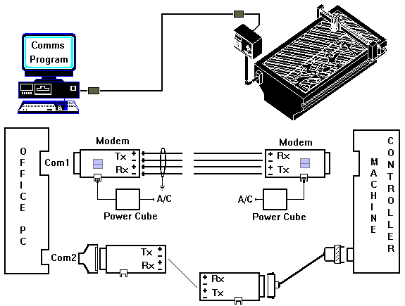

Unless the NC files are transported to the machine controller on a floppy disk, a communications link must be established between the office computer and the machine controller. The link could be either fibre optics or conventional cable. The diagram below shows a typical configuration for a cable link.
The office computer is linked to the machine controller over a cable link. The cable/modem and the comms software together are often referred to as the DNC link.

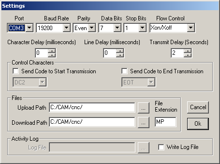

More information about DNC and Comms Settings can be found in the Communications Link Section of Troubleshooting.

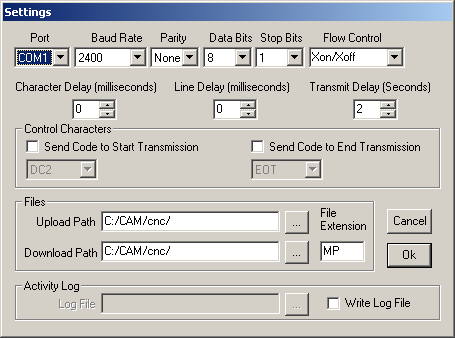

Normally the download executable (D6.exe, Burny.exe etc) can only be ran once as the configuration settings will inform you that the comm port is in use. The configuration settings or INI file is created by the software and amended whenever the download settings are changed. This means that if you have 2 of the same machine in the workshop you may need to have 2 separate INI files. The easiest way to achieve this is to create 2 shortcuts to the executable and place them on the Desktop.

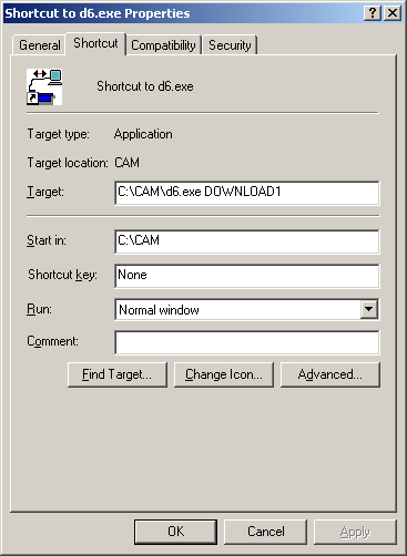

I will use the d6.exe in this help file but the principle remains the same for all Autodesk Fabrication download programs.
Properties on the first Shortcut Icon, type in a name to distinguish this download from the other. In this case I have used DOWNLOAD1.
select the Properties on the second download shortcut, this time I have renamed the program to DOWNLOAD2.
Click OK to apply the changes and double click on the shortcut to open it.
There will now be 2 INI files in the CAM folder, one called DOWNLOAD1.INI, containing the setup information for the first download, and the other called DOWNLOAD2.INI for the second.
So you now have 2 downloads from the one d6.exe file.
