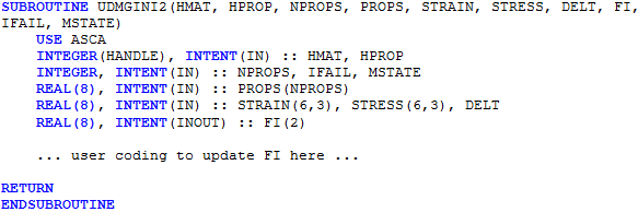

UDMGINI2 allows you to define the onset of damage initiation in a unidirectional composite.
Damage initiation can be defined at the constituent level (fiber and matrix) or at the composite level. This routine is called at every equilibrium iteration for every integration point of the unidirectional composite material for which you requested a user damage initiation routine. Here is a template for the interface to UDMGINI2
