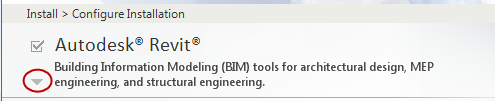

  1. Start the Revit installation program and proceed to the Install > Configure Installation page.
  2. Click the arrow below the Revit product name to expand the configuration settings.
