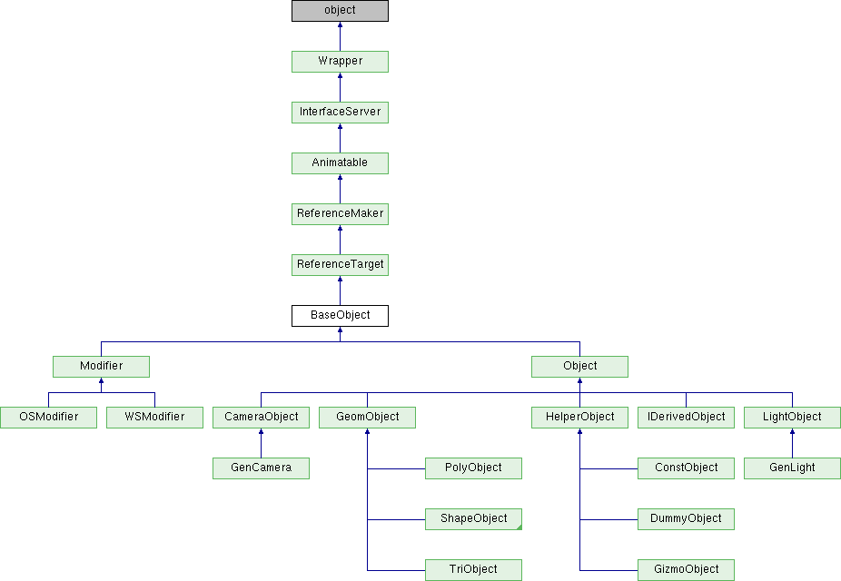

The base class for anything with a representation in the 3D viewport (e.g. objects and modifiers).
+ Inheritance diagram for BaseObject:
Public Member Functions
