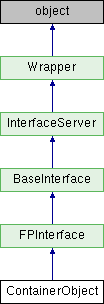

+ Inheritance diagram for ContainerObject:

- Public Member Functions inherited from FPInterface
def EnableActions
def FindFn
def GetDesc
def Invoke
def IsChecked
def IsEnabled
def IsVisible
- Public Member Functions inherited from BaseInterface
def GetID
- Public Member Functions inherited from InterfaceServer
def GetInterface
- Public Member Functions inherited from Wrapper
def GetUnwrappedPtr
