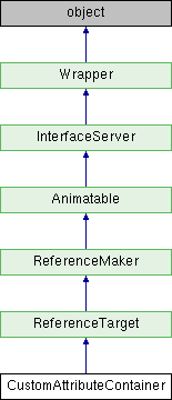

+ Inheritance diagram for CustomAttributeContainer:
