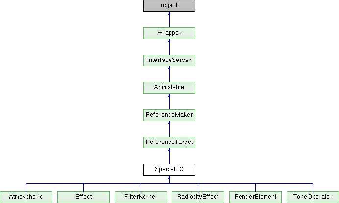

Base class for plug-ins that have an effect on the render like atmospherics and anti-aliasing kernels.
+ Inheritance diagram for SpecialFX:
