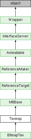

Class Description
Texture map base class
+ Inheritance diagram for Texmap:
