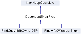

+ Inheritance diagram for DependentEnumProc:
