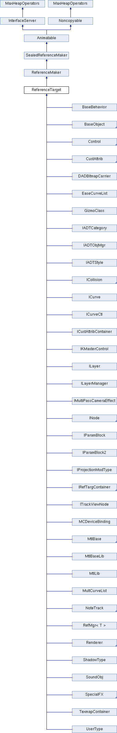

Inheritance diagram for ReferenceTarget:Public Member Functions | |
